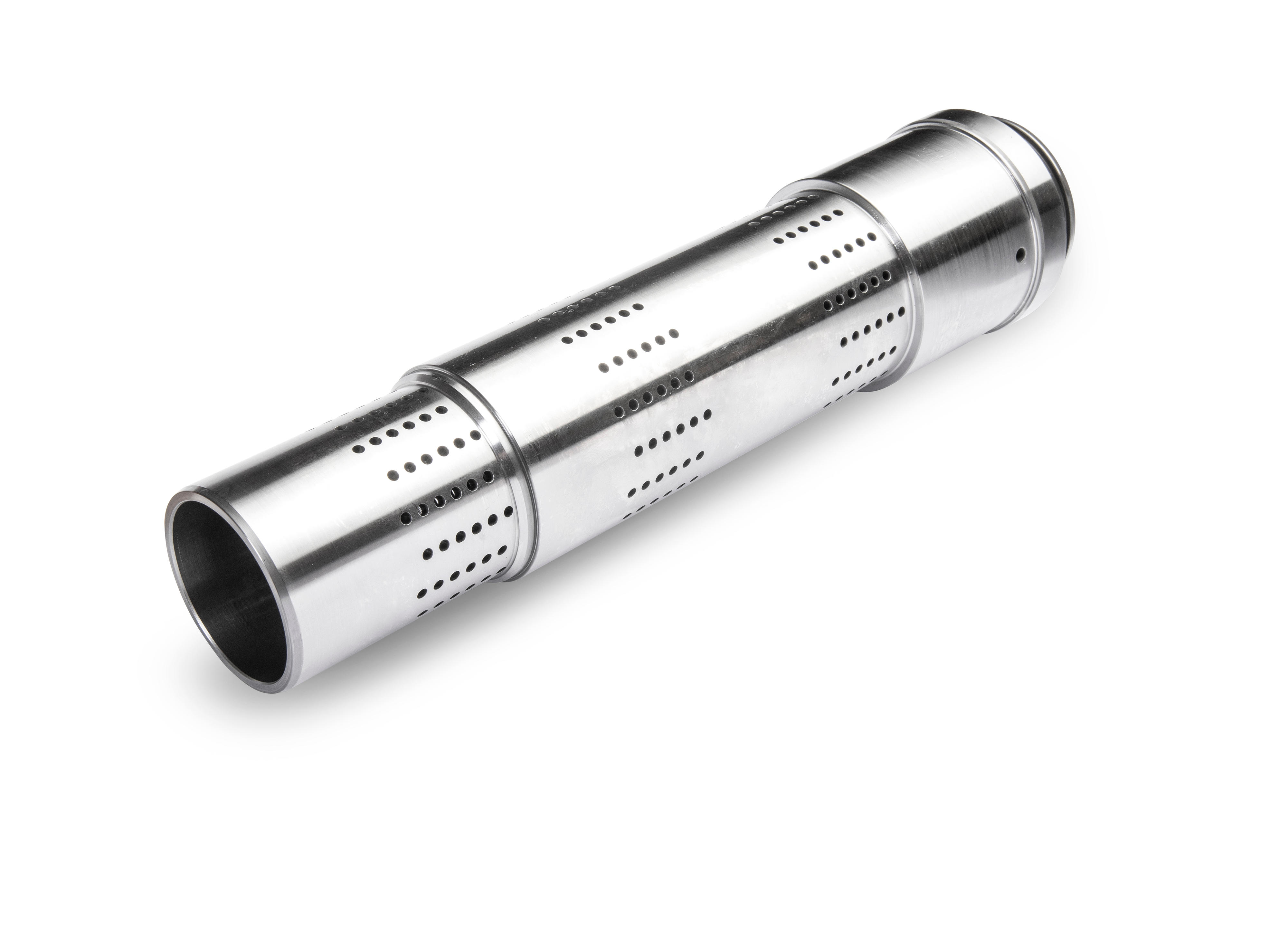

Many power plants generate energy by using steam to drive turbines that drive a generator. There, the kinetic energy is converted into electricity, just like in a dynamo. To do this, the steam must be regulated to the correct pressure and steam quality via a complex system of pipes and valves. This is precisely where HORA comes into play with tailor-made control systems. “We know the technological, commercial and organizational challenges of our customers very well,” says Andreas Petker, Head of Machining. “Every project is unique, so we are constantly faced with new challenges from development to production and final assembly.” This is where HORA's strength is evident: “Our innovative solutions ensure smooth operation, optimize processes sustainably and increase performance.”
With the Multi Threading 2.0 cycle and process integrated turn & mill machining, we were able to increase our productivity by 50 percent.
6-sided complete machining on DMG MORI turn & mill centers
As the control valves consist of a large number of sophisticated components, their precision plays a significant role in this performance. “That's why we only use high-precision machine tools,” says Andreas Petker, referring to the machine park with a total of ten turning centers from DMG MORI. “Complete machining in particular is essential for an economical and quality-oriented production.” This explains the high proportion of turn & mill centers. Larger components are machined on three CTX gamma 2000 TC, which HORA opted for at the time because of the user-friendly ShopTurn programming. For Waldemar Benks, who is responsible for process design in the machining department, this is an important factor in day-to-day business: “In these cases, we program the components exclusively on the machine, so ease of use is crucial.”
