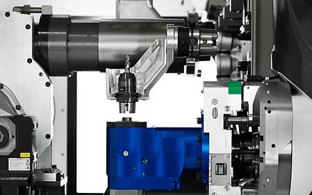

Angle heads have been state-of-the-art in the machining of complex parts for many years. They are used in particular for machining the inner parts of housing components in aircraft engines or stationary gas turbines, because it is often impossible for the main spindle to reach into the interior of the housing or to swivel in this position. Sophisticated workpieces made of materials that are hard to machine, such as titanium or nickel alloys, require the use of many different tools here as well as replacement tools due to the heavy wear. To date the changeover of tools in the angle head was either carried out manually while the machine was standing still, with the consequences for personnel costs and cycle times this involves, or by means of the automatic changeover of complete angle heads, that were either carried along or held ready on special pallets for each replacement tool. This results in high investment costs and a limitation of the system as a whole. In order to get around these uneconomical solutions, DMG MORI and BENZ GmbH Werkzeugsysteme have together developed an angle head for DMG MORI series machines that enables the automatic changeover of the front tools.
