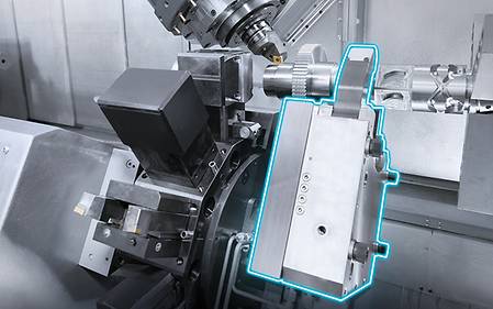

Steady rest for turret
  • Hydraulically operated steady rest to support long and slim components
  • Expansion of the possibility of using multi-channel machines
  • The cycle allows both approaching to and retraction from the steady rest
Customer Benefits
Themed image Steady rest for turret
Support positions in X and Z directly via the user interface. Automatic calculation of the approach and retract traverses.
  • Hydraulically operated steady rest in the tool table
  • Position-locking the turret leads to increased process safety
  • Fix the steady rest position, to position and shape tolerances to comply with the program after reboot
