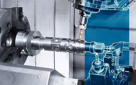

Tailstock for turret
  • Centring tip mounted on the turret
  • Centring tip data is saved directly in the tool memory
  • For fixed and spring-loaded centring tips
Customer Benefits
Start position and support position in X and Z-axis can be programmed via the operator screen. Monitoring of support position in a predetermined window.
  • Easy operation for positioning the centring tip
  • Position-locking the turret leads to increased process safety
  • Pressing force of the tip is variable, programmable and  monitorable
