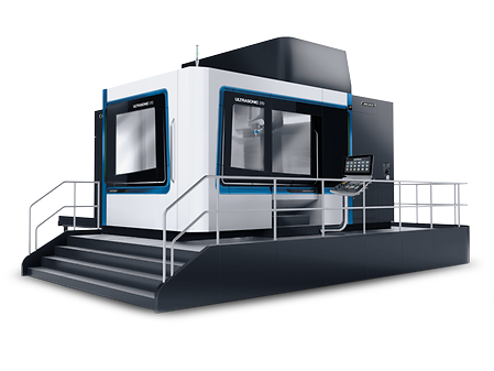

ULTRASONIC 210 P
5-axis ULTRASONIC machining in XXL
Max. X-axis stroke
83 in.
2,100 mm
Max. Y-axis stroke
83 in.
2,100 mm
Max. Z-axis stroke
49 in.
1,250 mm
Max. workpiece length
126 in.
3,200 mm
Max. workpiece width
98 in.
2,500 mm
Max. workpiece height
57 in.
1,460 mm
Max. workpiece weight
17,637 lbs.
8,000 kg

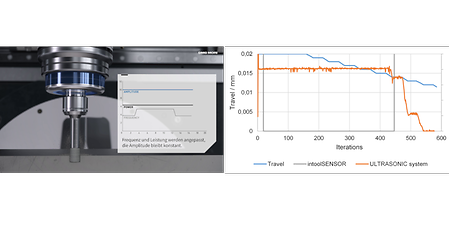

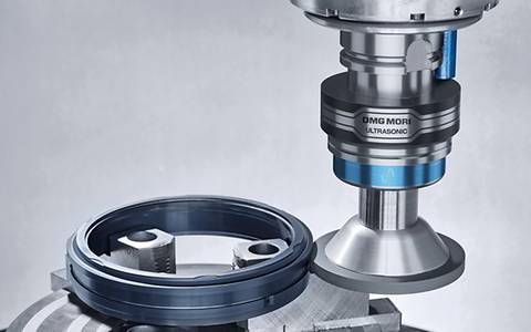

- Technology integration via HSK-A63 / HSK-A100 interface for ultrasonic superimposition of the tool rotation with amplitudes up to 15 µm
- Process forces reduced by up to 50% through ULTRASONIC enable, depending on requirements: higher feed rates, improved surface quality up to Ra <0.1 µm, longer tool life
- Specific coolant treatment systems with centrifuges, optimized for the ULTRASONIC processing of Advanced Materials
- Constant amplitude in the process to ensure reproducibility

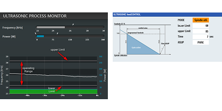

- Automatic detection of the working frequency, significantly improved hardware for signal acquisition
- Frequency tracking and simultaneous power control in real time for optimal process stability
- Ensuring the ULTRASONIC advantages even with non-optimal tools
- Fully compatible with 2nd generation ULTRASONIC actuator
- Band filter unit with 980 l as standard
Efficiency
- Fast innovative wheel type magazine with up to 303 tools with minimized footprint.
Highest rigidity and dynamics up to 6 m/s²
- High temperature stability standard with positioning accuracy down to 10 µm
- Position accuracy down to 8 µm with accuracy pack option
- Worldwide unique high precision varinat µPrecision with Position accuracy down to 4 µm
